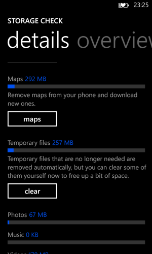

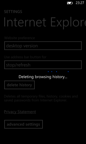

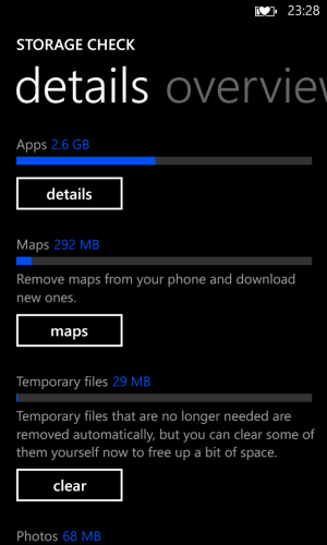

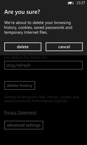

I'm not surprised with the discrepancy between MS and Nokia in regards to the temp file size. Most likely MS bundled everything together again :P lol. Have you guys tried deleting the ie history via ie as well? I don't have update 3 installed to check, I found that the Nokia's storage app currently does not delete ie history looks like the ie cache is locked - as you can see below: Nokia storage app does not clean ie temp files (L920 with Amber).
Edit: Tried clearing off the 29 mb but it doesnot go, not a big deal but the lowest I have had it is 5mb.

1) Some of it is part of the IE temporary files and clearing that through the IE settings will delete it

Thanks for that info. Suddenly my temp files went up to ~70mb on my 925 (GDR2/Amber) (I know, I know, nothing compared to what others here are struggling with) and after I deleted the browser history it went down to 13mb. Still not sure what the rest is but better than 70!

I have the same issue on my 920. Had >450MB on temporary files and couldn't delete it. Now I went to IE options and deleted the browsing history and the temporary files lowered to 174MB. IDK if it is possible to reach 0MB.
