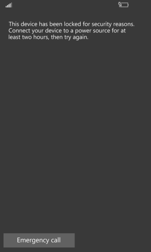

Device locked with no option to open! Tells to connect to power source.

Today morning, my Lumia got fully discharged. So, I connected it to the wall outlet and the screen showed NOKIA logo, then the large battery and then switched off. Again same thing happened. I then plugged in my phone to the laptop but the same thing was repeated. I left the phone connected to the laptop. After about half an hour, I double tapped the screen and it had charged but after I entered the PIN correctly, a note appeared that read "This device has been locked for security reasons. Connect your device to a power source for at least two hours, then try again".

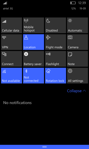

I could access only notification centre by swiping down and everything worked there like flight mode, bluetooth etc. I was able to save screenshots. I could receive a call too. I am not sure why this happened. Does anyone have any idea?
I then left my phone for over two hours connected to power source but nothing happened. It would still not unlock.
Then I headed over to the Microsoft website and locked my device from my account with a 6 digit PIN. Then, I was able to unlock the phone using that PIN.

Today morning, my Lumia got fully discharged. So, I connected it to the wall outlet and the screen showed NOKIA logo, then the large battery and then switched off. Again the same thing happened. I then plugged in my phone to the laptop but the same thing was repeated. I left the phone connected to the laptop. After about half an hour, I double tapped the screen and it had charged but after I entered the PIN correctly, a note appeared that read "This device has been locked for security reasons. Connect your device to a power source for at least two hours, then try again".
I could access only notification centre by swiping down and everything worked there like flight mode, Bluetooth etc. I was able to save screenshots. I could receive a call too. I am not sure why this happened. Does anyone have any idea?
I then left my phone for over two hours connected to the power source but nothing happened. It would still not unlock.
