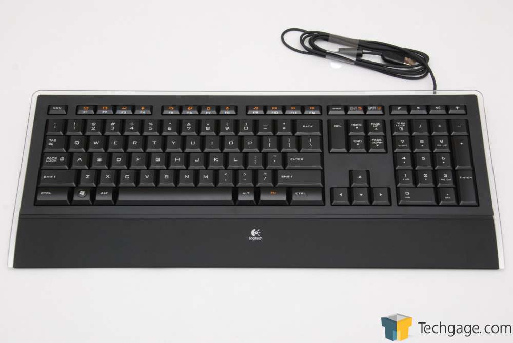

If you want a nice professional looking keyboard. I personally recommend the Logitech Illuminated keyboard. Sadly it's not wireless. There is a wireless (2.5Ghz, not Bluetooth) version, but the key stoke, key engraving, and back light illumination are all inferior. Not awful, still fine, but not as good.
