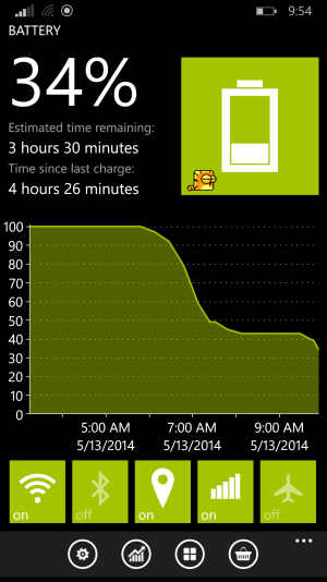

Location services is a disaster in 8.1.
The steep drop represents about an hour of navigation with Here Drive. You can see the discharge starts shortly before 6 AM and stops at about 7:30. When I started my travels, I was at 98%:
