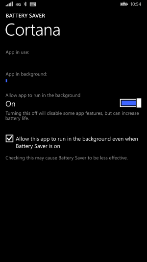

I am constantly using Cortana (especially since I am testing it) and this is typical for what I see in the Battery Saver:
