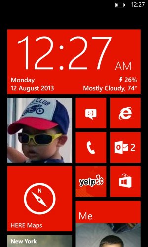

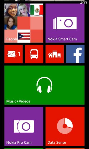

After thinking about it and evaluating the pros and cons I flashed my phone two days ago. I have all the 1020 apps.( Nokia Pro cam, Nokia Video trimmer and Nokia Video upload). I'm running the Euro Dev Rom not the French one. When i install the spanish mexican keyboard tethering worked for a while but then i check yesterday and i stopped working and gives the message to call 611. I don't see L(LTE) symbol but i do see H and H+. The speeds are better than before. I use to get 5 to 6 download and now i get 8 to 9 . For being on Net10 which is the reason i only see H or H+ i think those speeds are more than great. This is wayyyy better than AT&T stock Rom. As long as i get the OTA updates i don't care and don't regret flashing the Rom and if not i'm sure there is going to be the possibility of updating manually by flashing. Here are some screenshots of my phone.
what clock/weather app is that? It looks nice.
That's TimeMe app but is the side load version. I side load it with a student developer account cause the regular marketplace app doesn't update every minute and the time falls back. In the marketplace app page in the info there are the instructions to go to the website of the developer of the app where he explains how to side load it
