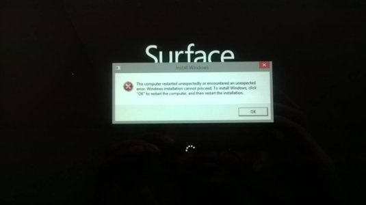

also a BS afterwards;
Second, surface turned itself off when I plugged in headphones listening to xbmusic
aaaand it happened again while on facebook. im going to reboot the machine and itll hopefully fix it.
well my surface is on a loop now and wont load. stuck on this screen. gonna go exchange it.

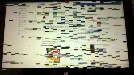

That is one of the issues I had on two of my first three Surface 2's ... the random color bars. I'm on my fourth and it has been flawless until last night when browsing this site; it did that exact same thing. I think the problem with my second unit s it did that during the initial install and destroyed the unit, as such.
So with so many people around having this issue I hope it's software related and can be fixed with a firmware upgrade.

Ok, I use my surface about 3-4 hours a day and this now occurs about once a day. Does anyone know if Microsoft is aware of this issue and if a fix is coming?
Had the same issue from day one. Replaced unit and new Surface 2 so far (touch wood) hasn't had the same issue.
Ok...because mine still does this daily. So this is "normal" at this point and there should be a fix?
Well, normal it isn't but I guess it's not hardware related and can be fixed with an update. But the funny thing is I'm 99.999% sure that this is actually caused by one of the current updates on Microsoft Update, most likely the Surface firmware from 22 October.
It happened with 2 machines here, on the third I disabled Windows Update and this one is running fine. Will keep updates disabled till Microsoft finds out what the hell is wrong.

I received my replacement Surface 2 on Monday, and so far so good--no wonky screen. Although it concerns me that a couple people on the Microsoft Community "Surface 2 Display Crash" thread reported that their Surface 2's worked fine for a couple of weeks, and then started having this screen issue again. Software issue? Fingers crossed that mine is good for the long haul. FYI, the lot number for my replacement Surface 2 is 1343X.

I had totally decided on the Surface 2 to put on Santa's list ;) ... I am so awed by the videos I've seen. So, I went to Best Buy today to do a hands-on and it was awesome! I was able to play with everything, because they actually had Internet connection, etc. Then -BOOM- the weird pixelate screen thing happened. I held the power button down then restarted it and it came back fine ... and never repeated the issue during my playing with it. But now I'm afraid there is a huge problem that may not be software since Microsoft is suggesting returns/replacements. What do you think the odds are that any unit ordered in the next few weeks will be the same manufacturing lot - probably pretty high, right? Should I still get one?? What would you guys do?
