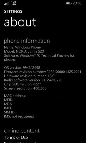

tried another method of registry editing via custompfd that worked fllawlessly on my L520.
Now will try this method on my brother 520 and will let you know. as custompfd method gave error 81088308 on my brother device

yes it is very easy but sd card method was useful only if you are on 8.1.
On 10 we are not able to give sd card permission due to new file picker api.
hoping this fiddler method will be useful for future builds too.

try to use this fiddler one and make sure you change PhoneManufacturerModelName to RM-978_1046(this is lumia 630 it worked for me)
