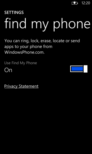

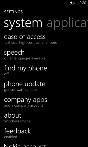

This has worried me since I got the phone. Under the Settings, "Find My Phone" is always shown as "Off".
Tapping on it and getting to the underlying option to set it, I was able to set it to "On". When I go to MS's find your phone webpage I can find my phone. Whew. But why is this happening? Is it this way with the other Lumia 920s out there? All WinPhone8 handsets? My 920 is from AT&T and came with the Portaco update installed.

Its on, its show OFF to choose that option. If you go to windowsphone.com and click locate it will locate your phone.
Can someone please confirm it is normal that when the phone finder is turned 'on', that in the application list (under settings) it shows as 'off'
Can someone take a screenshot as-well? what would be considered "off" and "on"?
Cause while I have both boxes checked, when i go to the website and refresh my location, it cannot find my phone.

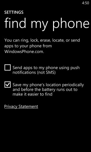

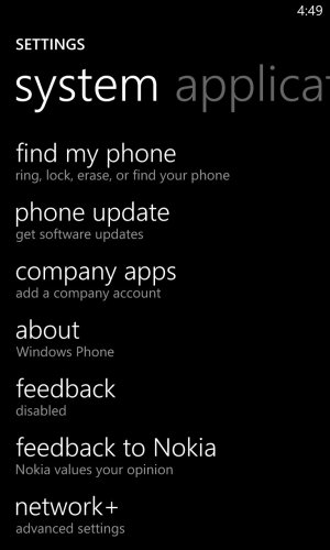

I dont have those setting options (in the 2nd picture), i only have a slider for phone finder 'on' or 'off'
Yes, my previous 920 had those options, my new replacement doesnt.......perhaps they'll reappear on an update.
I have the same settings at the screenshots, they have always been the same (before and after portico). US - ATT - Portico updated.
before portico i had the setting where it was a slider that you can enable on or off. after the update i now have the options as pic 2. maybe the international ppl still have the slider and u.s. and canada ppl have the check marks? as far as the windowsphone.com site goes, it can still locate your phone even if you have it unchecked in your phone settings. it goes off of the last location known. so if you are still in the last location known, guess what? it's the same for backing up your apps. from the site you can resend an app you previously installed to your phone as long as you have the push sms option in your phone settings check marked. on the site it will tell you your phone could not be reached but your app will still be sent to your phone and installed.
