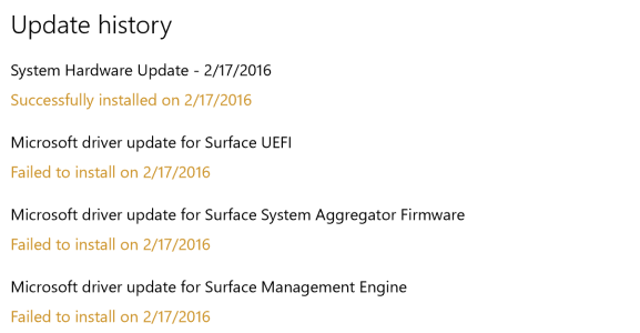

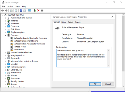

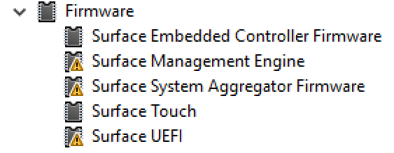

I have rebooted several times manually with no change. I am not sure what it means that the Surface Management Engine won't start.

Windows update says that my device is up to date. One time it caught a Defender update, but that's it. I tried uninstalling the drivers in Device manager and restarting but no luck there either. It booted back up and the errored out firmware reappeared. I am out of other ideas other than contacting Microsoft.
Other than that my book still seems to be working, at least as well as it did.

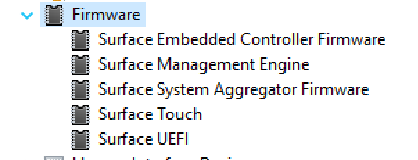

UPDATE: After 5 hours of not cooperating, I was using my book on battery power and restarted and the update sequence started up again. Surprising but the only thing I can figure is that it was NOT plugged in. All good now, though:
