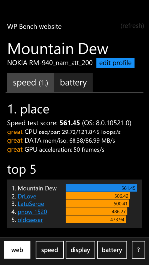

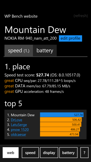

Hello everyone. I hadn't seen a thread yet from anyone with a 1520 that had decided to bite the bullet and install the latest GDR3 developer preview update.
I finished the install a little bit ago and decided to do some benchmarking to test out the differences from the 10517 build that already ships on the device. I had already noticed some performance improvements as noted in the news article on the front page, but I wanted to see if this was a placebo effect or a real performance change I was seeing. Sure enough there was a 6.4% performance difference in favor of the newer build.
Here's the before and after benchmark results.
Before (10517):....................................................................After (10521)

The pics tell the story, but I'll explain it as well. :)
The 1520 ships with version 8.0.10517.150.
The dev update is version 8.0.10521.155.
Make sense? :)

I had actually performed multiple runs (10) before and after the update and the results were fairly consistent. Some minor differences in score (like +/- 1 point) on the individual portions. So overall it should be indicative of the 6.4% boost I mentioned in the case of the AT&T 1520.
View attachment 51712View attachment 51713

Soo, I don't have a 1520, but I ran wpbench on my 1020 post-update, and the score is inline with non-updated 820/920/1020s with snapdragon S4. So, I don't think it made a difference on my end. Could you run sunspider 1.0.2 through the web browser and post a screenshot or tell us your score post-update?
