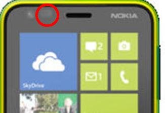

Hi, are your phone goes black right after and all the time when in phone call, or only when your phone near your ear (or you can test by cover/hover the sensor with hand)?
If your screen always black when calling even nothing near screen it might be your proximity sensor has problem.
The sensor is here:
You can try to clean it. And that sensor should not covered by anything, even with transparent screed guard. Are you using some kind of screen guard?
