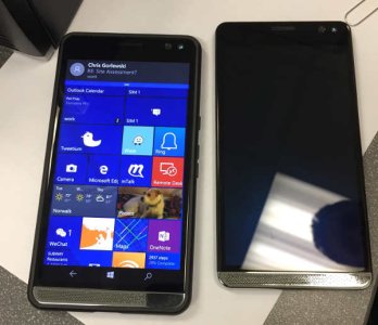

I'll post photos of the brick and the side-by-side as soon as possible

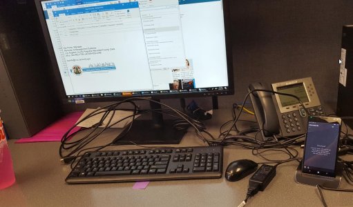

Was using the continuum all day today. Works flawlessly. Of course, most of the work is by using Remote Destkop into my Surface Pro.

Hey, could you tell me which cable your using to connect the dock to the monitor cause i have tried a displayport to hdmi and a USB-C to hdmi without any luck. if you could share the cable brand or link of which one you bought that'll be great.
