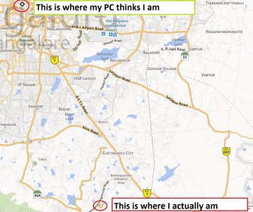

As mentioned by realwarder, the local tower to which your phone is connected is not beaming down location (AGPS) information properly. So what the phone/app is doing is that it is picking up location based on your data connection provider's IP address. This happens quite often to me on my desktop PC running Windows 8.1 which doesn't have any GPS system attached to it.
So best option is to contact your carrier.
To illustrate better what I am trying to explain.
