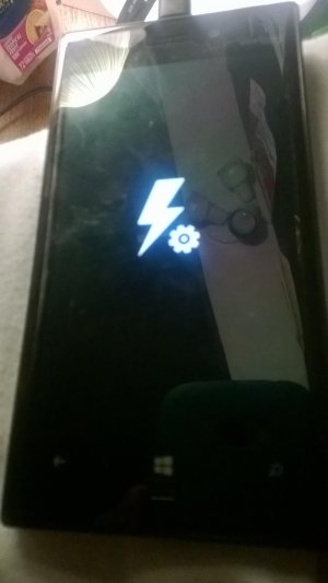

Thanks for the reply pechio. Unfortunately, I have had no luck with that particular solution. Right now my screen is no longer the familiar two gears spinning. Instead, one of the gears has been replaced by the lightning bolt. I'm going to flash it before I go to bed tonight, maybe when I wake up it will be fixed... LOL. I've attched a pic of the current screen my phone is displaying. Thanks again. WP_20130831_014.jpg
Thanks for the reply pechio. Unfortunately, I have had no luck with that particular solution. Right now my screen is no longer the familiar two gears spinning. Instead, one of the gears has been replaced by the lightning bolt. I'm going to flash it before I go to bed tonight, maybe when I wake up it will be fixed... LOL. I've attched a pic of the current screen my phone is displaying. Thanks again. View attachment 41855
how did everything work out for you?
