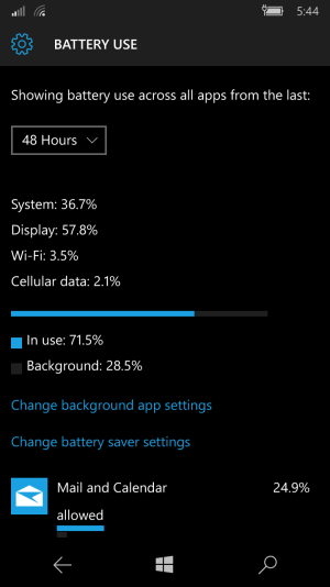

The strange thing for my Lumia 640 is that it battery stats state that the screen used 60% of battery, However, the screen was off all day, except for checking a couple of texts. Glance screen is set to 30 sec. timeout. Does the screen consume power even in standby?

Please post a screenshot of your battery status and battery usage page.
Thanks, here it is:
This includes charging for the last 8 hours.
As I said, battery use states that screen use was almost 60% of use, when the screen was barely on. Most of the drop in battery use occurred during standby, while only checking a couple of texts and battery status every few hours.
