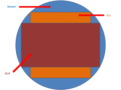

Your sensor is round. Rectangular Captures of 4:3 and 16:9 have to fit inside the circle...
Alternately, try ProShot which lets you adjust to a wider range of MP captures within the settings. It won't give you more on the high end (or not very much more, depends on aspect ratio)... You can only fit so many MP into that rectangle at 4:3 or 16:9 out of a round sensor and camera gives you the highest choice. ProShot will match the highest choice and give you more intermediate steps.
