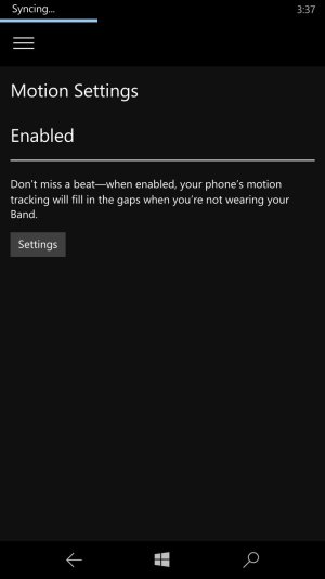

For the people noticing higher step counts, check the "My Phone" section in the health app (this might only be for Windows Phone users). The update seems to have broken the phone motion data collection settings. I always had this turned off previously but the update turned it back on and the settings page is broken and doesn't let you disable it.

*'Wiggles' is on to something with step count. Although the health app is showing motion count as being disabled, when I checked settings in my phone, motion data was now enabled, so I disabled it. Gonna have to keep an eye on that.
My steps were up about 30% yesterday for a day with similar activity level. Can someone please explain how to turn off motion tracking in windows phone?

Can you share a screenshot of motion count being disabled in the Health app? I cannot turn it off after the firmware update (tapping on "enabled" does nothing). I think there is an issue with the Insider .71 Windows 10 Mobile OS build and the new band firmware/health app version.

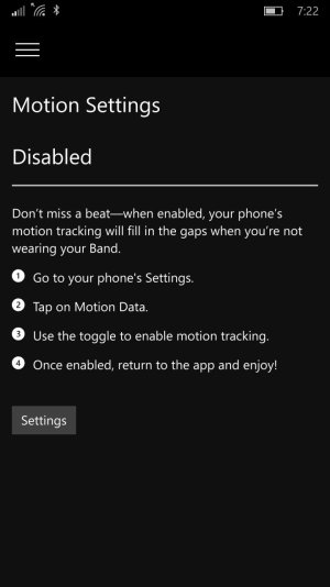

Here you go. As I said, its weird because the app was showing disabled, but yet the phone showed enabled, with Microsoft Health being the app using it. I had to disable it in the phone settings. This is a Lumia Icon, btw.
David, go to 'settings' and search 'motion'. I think its under the 'privacy' heading. From there you can disable it.
