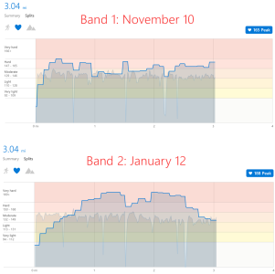

Throughout the day, and even while sleeping, the heart rate numbers reported by the band2 seem reasonable to me (say, 50-60 at night, 65-80 when awake at rest, and a bit higher when more active). But when I'm running, the numbers climb up into the high 180's and the high end of my reported range extends up to about 189.
Now, I'm over 50 and not running very fast or working very hard (say, 10-minute miles), so I seriously doubt my rate is that high. That actually seems like it would be dangerous if true. But I really don't believe my actual heart rate exceeds 160 or so, and when I pause to check my pulse manually it doesn't seem very high. I believe that on the high end, the band is reporting numbers around 30 bpm too high.
Are others seeing this behavior? I wasn't seeing this issue with the band1.

I have only the band1 vs band2 comparison for the same route. Looking at several examples, the differences are not as consistent as I hoped, but the band2 does seem to report about 20bpm higher. See example below. My other reference point is that I had previously compared the band1 to a Garmin watch with chest strap, and found the results "close enough" (that is, band1 vs Garmin).

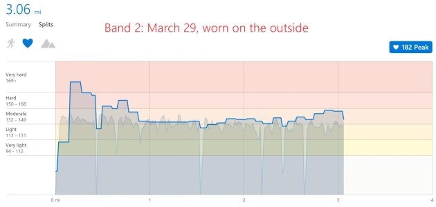

Update: After input from HSolo, I ran with the band facing outward, and received much better results:

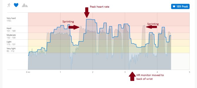

Wearing the screen on the outside feels so awkward to manipulate the buttons or look at the screen that I never considered trying it that way for workouts with the Band 2. I did so today on a 4.5 mile walk/jog to test the difference. Twice during my workout, I went into a full sprint to really get my heart rate up. I was surprised at how much the heart rate sensor placement actually made a difference.
I've noted on the attached screen shot the moment when I flipped the screen from inside to the outside of my wrist and the times where I sprinted leading to a heart rate spike. I manually counted my heart beat for 10 seconds after the first sprint and estimated it to be about 150 bpm. The spike with the screen on the outside of my wrist seems to be right on with that count, while the peak with the screen inside was measured at 189 bpm.
It seems like gwinegarden's results are showing that this technique is not helpful for other types of exercise, but my results agree that it helps for running. I've updated my post near the top of this thread to show the new results, same course with the band worn on the outside of the wrist. It's hard to say exactly how accurate the readings are, but it certainly seems a lot more reasonable. There was a fairly high spike near the beginning but after that it settled down to a fairly consistent value, similar to what I had experienced with band1.
My average heart rate recorded for the run was 140 (compared to 148 on the band1 example, and 165 on my original band2 example). The 140's range seems appropriate to me. I'll definitely be wearing it on the outside for running now. Harder to read and use, but certainly more accurate.
