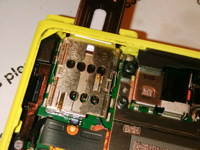

This is what it should look like:

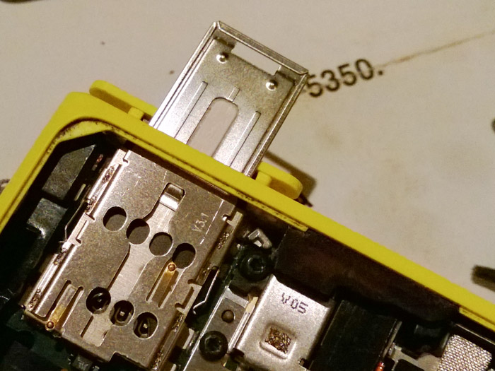

Then you can slide up the metal tray that holds the moisture indicator out like this:
Now you should have the three lower SIM pins exposed. As you pull the tray out, you'll see exactly how the pins are catching the SIM adapter and making it stuck. So what I did was pull on the tray gently until the pins were jammed on the adapter, then with a regular sewing needle, I pushed each pin down one by one. It took me about 6 tries but I got them all down. Be patient and don't force it and you'll get it.

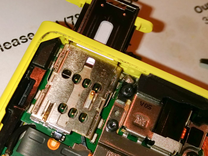

Now do the same with the upper pins.
And now your tray should be free! Now I can see I would have really busted the phone if I had forced the tray out.
