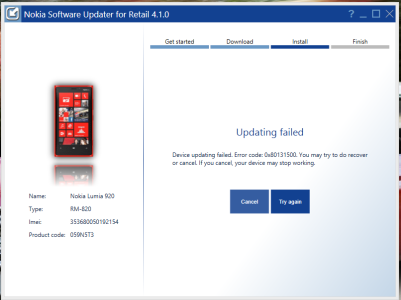

I did also attempt to use the "Nokia Software Updater" but no luck with that ether. Here is what I see for that:
Error : BppWngz.png
I was sitting with a Nokia boot logo with a red background for awhile but the device has turned off and I can't get it on now.
Anybody have any suggestions?

I had to fix a friend's 920 that was stuck on the gears, and when I did the Nokia software updater the first couple of times it gave me an error. I just clicked try again and after the third time it worked for whatever reason.
