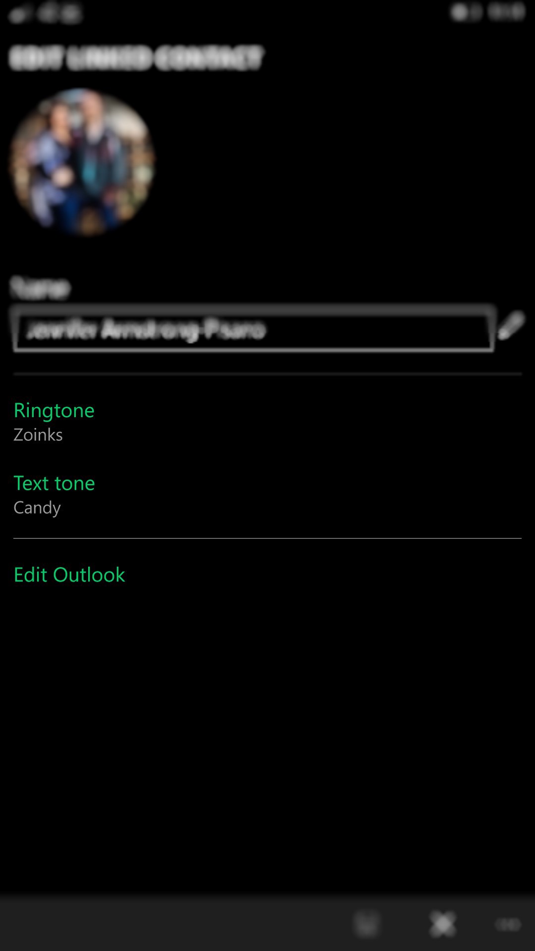

Re: Custom text tones on contacts
@xrs22... mine looks the same way. But once I changed the default, every text plays the what I have selected over the default, no matter what the individual is given.
