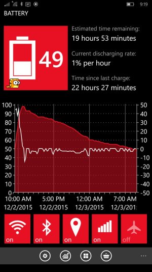

The battery just gets better and better for me! It's been 18 hours and 34 minutes since last charge, and it is at 62%. Estimated time remaining is 17 hours and 49 minutes.
That is a really great improvement, considering the first few days it only lasted for 9-10 hours with no use! :)
Edit: Just want to add that I've had it since Thursday, and the battery improvements came after I did a hard reset (and switched some SIM-settings). Check out my previous post for more information regarding that :)

Initially my battery life on my 950XL .... approximately 1/2 day under my usage (which obviously won't work). I tried everything to understand what was happening and could not figure out the cause. Just before returning the phone, I did a full reset and did not restore from a backup. After approximately 1/2 day ... the battery was no longer getting hot and I can now get a day and a half under my usage (bluetooth on, wifi on, location on). The battery is getting better.
I have noticed that when I go to the gym (metal lockers), my battery drains very quickly when I leave it in the locker. It must be working very hard to find a signal?
Of note, when my battery was draining quickly, my bluetooth was bad, my reception was poor and the phone was not working properly.
All good now ... and it seems to be getting better. I do still think that we need the next update to have the efficiency back of 8.1

Just to finish my point, here is how I expect phone life to go under Windows 10. If it is not similar after 5+ days of trying, it fails. This is under moderate usage all day long, polling 4 email accounts in real time, at least 30 minutes of a game, text messages throughout the day, a few pictures, over an hour talking on the phone, 50 minutes of playing music in my car via the headphone jack, and some web browsing. Bluetooth, wireless, cellular data all enabled, connected to a Microsoft Band.
