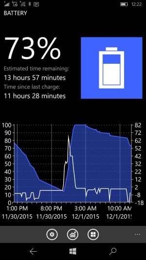

Update 2: Since allowing the battery to go to 0%, battery life appears to have improved. Since taking it off the charger over 4 hours ago with very light use, battery is at 93%. I also turned Windows Hello back on after removing from charge.
Previously, the battery lost 10% per hour and the battery app showed any from 4-8% discharging rate (just sitting idle). Now its showing less than 2%.
Check out the slopes before and after.
Update 3:11hours off the charger and at 73% with light usage(emails, WC App, edging), no games, hello on)

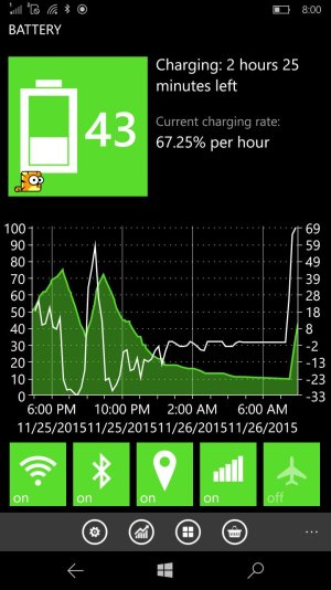

Took mine off the charger at 6:30 this morning. By 8:00 I was down to 80%. It's now 1:00 and I'm down to 40%. I have done nothing but a little surfing and checking email. No videos. No music. Haven't even talked on it. I have only been letting it drain to 10% each cycle. I'll take it all the way to 0% and turn off Hello and see how that does and report back.
Guys - disable messaging backup in Messaging + Skype. It is completely broken and will drain your battery like crazy. After doing this I went from -15%+ per hour down to -7% and hour. Still not great, but I can get through a day now. The OS is not finished, its **** we have to deal with this, but I highly doubt it is a hardware issue.
