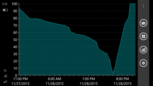

Phone came off the charger at 10:45 AM. Was at 11% at 12:37 AM the next day.
Seriously, check what apps you have running in the background.
