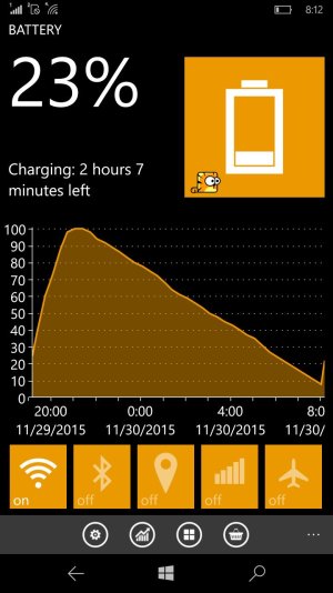

My battery life has been really bad so far. I might have just recieved a bad phone though as it keeps getting very hot no matter how many times I have reset it. Even without usage the battery is draining quickly. I tested it last night by not plugging it in when I went to bed and it went from 100% to 10% in six hours with no usage. I'll give it a week before I return it.
I just did a hard reset. Will report back with more information regarding the battery in a few hours :)
My battery life is so bad I cannot use wireless or plug into a computer. They do not charge it fast enough to prevent it from draining. This is with airplane mode on, glance off, NFC off. This is not just breaking in. I have never had a battery this bad before.
That is not your battery, your phone is wildly drawing power for something.
