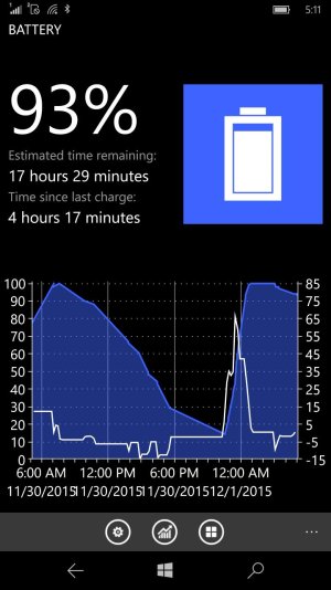

As stated, let my phone go to 0%, dead.
Plugged it back into the charger and after it had enough juice to turn itself on I immediately checked and it was already at 22% in the span of a few minutes.
Here's what's interesting, since day one 11/25, the phone runs quite warm during charging. Its at 40% and cool as a cucumber.
I'm starting to think something is off and not "inline" as mentioned in this thread. Letting it die allows the phone to learn what zero is or something like that. Will see what happens on the next run.
Update 1: The cool charge was due to using an old Samsung (1A output) charger, once I plugged it into the charger that came with the phone (surely a QC 2.0) the phone became warm near the bottom. Warm as a bagel. The battery app confirms that the Samsung charging rate was 30% and charger from the box is 61%.
Update 2: Since allowing the battery to go to 0%, battery life appears to have improved. Since taking it off the charger over 4 hours ago with very light use, battery is at 93%. I also turned Windows Hello back on after removing from charge.
Previously, the battery lost 10% per hour and the battery app showed any from 4-8% discharging rate (just sitting idle). Now its showing less than 2%.
Check out the slopes before and after.
