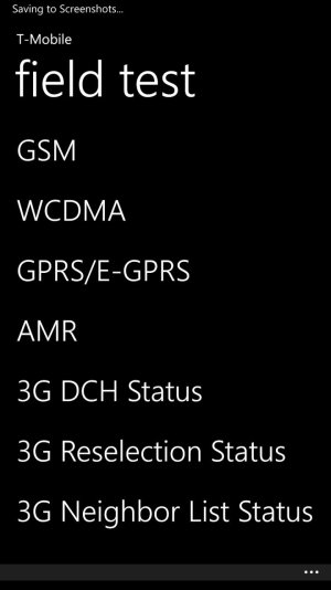

Step 1: Go to the dialer and dial ##3282# (no need to press send, the final "#" will automatically take you to the next step. Picture is edited to represent what needs to be input)
Step 2: Accept the disclaimer and enter Field Test
Step 3: Click on the ellipse on the lower right to bring up the Settings link
Step 4: Change Network Type from Automatic to Manual. You should now see a "Supported Bands" list populate reporting "13/14 bands active"
Step 5: Enter the band sector and scroll down to "B4-WCDMA US 1700" and click the check mark. Make sure to then hit the check mark at the bottom to save the settings.
Step 6: Make Sure that Supported Bands now reads "all bands active"

Thanks. Looks like I am getting UARFCN readings of 462 and 2062, which appears to be the PCS 1900 and 1700 bands, respectively. Guess that proves it works
