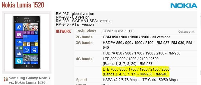

It does have 700 LTE band according to spec listed.
Nokia Lumia 1520 - Full phone specifications
It's all in the details. While it does have 700mhz support, its only on band 17. Because of complications in Block B and Block C LTE, band 17 devices can not receive all of the 700mhz LTE band. This means they cannot receive band 12 signals, which means that you will not get low band T-Mobile LTE. However this network doesn't exist yet, and will probably take at least a year to be relevant. Since the AT&T 1520 supports all the other T-Mobile bands, it's definitely worth picking up for use on T-Mobile. I've seen as high as 60mbps down on T-Mobile on my AT&T branded 1520.

Does this really work? anybody can confirmed this works on T-Mobile 3G 1700 band? or is it hardware locked, need unlocked 1520.3/rm-938 only. what about t-mobile 700 LTE band. Recently news says T-Mobile is increasing 700 LTE band.
If you read this thread it is confirmed that it enables T-Mo compatible 1700 MHz AWS for 3G/H+ reception in all T-Mo legacy areas which have not had an LTE rollout. It effectively makes the RM-940 3G radio identical to the 3G radio on RM-938.
RM-940 (AT&T) and RM-938 (Latin America) have identical LTE radios.
AT&T uses LTE Bands 2@1900, 4@1700 and 17@700 MHz
T-Mo uses LTE Bands 2@1900, 4@1700 and 12@700 MHz
Source: List of LTE networks - Wikipedia, the free encyclopedia
The difference between Band 12 and Band 17 is that Band 12 is broader... It encompasses a higher and lower end point than Band 17.
Band 12 uplinks on 699-716 MHz and downlinks on 729-746 MHz
Band 17 uplinks on 704-716 MHz and downlinks on 734-746 MHz
Source: E-UTRA - Wikipedia, the free encyclopedia
Note that Band 17 is a subset of Band 12. A Band 17 radio falls right in range for Band 12 and will cross over.
A Band 12 radio may not work optimally on Band 17 as it might try and "talk" to the towers outside of their "listening" range. This is why AT&T is resistant to rolling out Band 12 as it would strand AT&T users with only Band 17 on board.
So Band 17 (AT&T) can substitute for Band 12 (T-Mo).
Both RM-938 and RM 940 have everything they need for any AT&T or T-Mo compatible service...

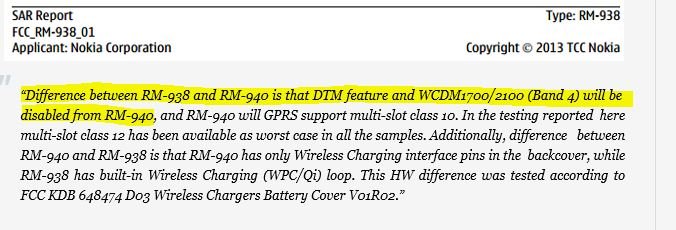

Here's more from: Nokia Lumia 1520 passes through FCC - ThePocketTech
The point of this thread is to enable what was disabled at AT&T request and "hidden" from casual users.
Well one can claim the same thing about the AT&T 920 and Rogers variant, AWS disabled. By now everyone who tried has been unsuccessful. Field Test mode was disabled on the AT&T ROM but not on Rogers. Folks who have flashed the Rogers pre-portico ROM onto the AT&T variant (including me) couldn't enable AWS through Field Test, even though the option is checked. Heck even the now discontinued Lumia 810 had the LTE option in Field Test, which really didn't mean anything. If a band is disabled by hardware there is no way it would magically enable after flipping switches in higher level ROM access menus (such as Field test).
Again I am not saying that the RM-940 doesn't support 3G/HSPA+ on AWS, I just want someone to confirm it and UARFCN band while being used on T-Mobile's HSPA+ would confirm that
