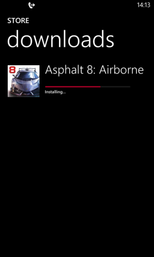

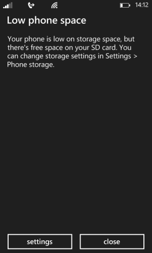

Hi, I was trying to install Asphalt on my phone which was having around 2 GB of free space, while the installation was in progress, I get a message that there is insufficient space, so I decided to remove the app by long-pressing the ongoing installation and tapping uninstall. Now the installation process is stopped and the app is nowhere listed any more, but my phone is showing available space of around 700 MB, I believe there are some temporary installation files which did not get removed in uninstall process, so how can I get the space back, I have tried restarting the phone but there is no change, I really don't want to factory-reset my phone, would appreciate if I can get some help on this.

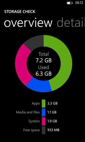

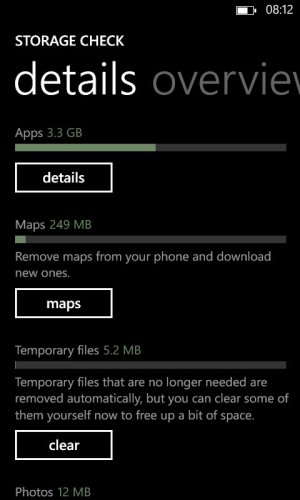

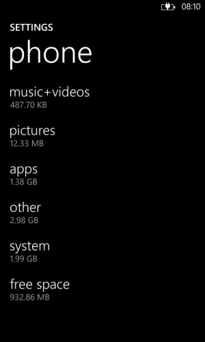

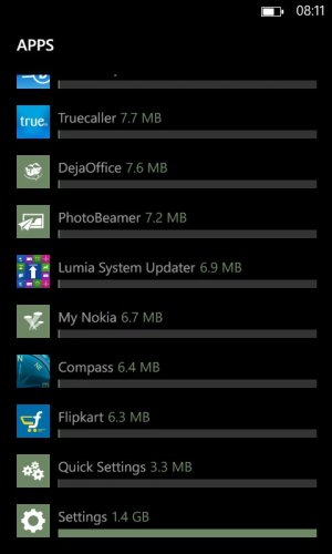

Thanks guys for your valuable comments, I did tried the date changing method which recovered around 200 MB of space, still there is around 1.5 GB of data which is not recoverable, I am attaching few screenshots to give you a better idea, I see lot of space occupied in "Settings" and "Others"
BTW, I have a Lumia 720 with Amber update.

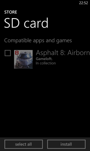

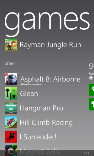

What a coincidence!! I am under the same crisis, from the morning. I downloaded Asphalt8.xap and put it on my SD card. Everything else is just like what happened to you :/ I am confused. Should I wait for GDR3 before hard reset? Or go ahead and do it right away?? :P
I faced this issue sometime ago when I purchased Asphalt 8. There are two remedies for the same:
1) I'm assuming you are trying to install the game from SD Card (From my case). In which case just try to install it again. At some point it will notify that there isn't enough space to continue installation. The app will show "Attention required". Tap on it and it will take you to the store page. Long press and hold and select cancel download. It may take some time but keep patience and don't restart your phone. After a while notice that the space used up in settings is reverted back.

I faced the same problem with Halo SA. I tried clearing temporary files, using 'storage cleaner' app, and date changing trick. None of those worked. I had to hard reset my device in the end.
So my future advice to you : If a app is in 'installing' phase do not try to remove it. If the low space message appear, skip it wait for the OS to manually stop the installation program and it will say 'attention required'. then you can remove it.

I couldn't make space to reinstall A8 :/ But I did your procedure with another xap.. Now, waiting as you said.. Lemme see :/

The app requires around 2.5 GB of internal memory free space at the time of installation (via the SD card method) even though after the installation it takes 1.4GB. I got the error that I was out of space couple of times and I had to keep uninstalling other apps and games to make space.
@ sillydude20 : I would have definitely gone by point 1 that Gaurav Paul suggested. However yours is one typical case where you cannot reinstall it via the store or SD card either. If your helpless then go in for a hard reset.
This is very weird. I have just 1.2 GB of free space on my 720. Yet I'm able to at-least start the installation process. It gives the same error messages though after sometime which I posted earlier. Can I suggest you perform a soft reset and try to install the app again?
