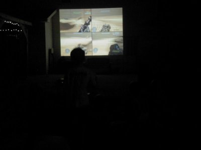

Here's the projector...its an old one now, but its a high quality, made in Japan projector and I'd like to keep using it.
http://www.projectorcentral.com/Epson-PowerLite_703c.htm
We use it to play xbox outside on the house on weekends during the summer...lots of fun! (The lines are from the siding...after about 5 mins of playing, your eyes/brain don't see them anymore.)
