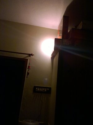

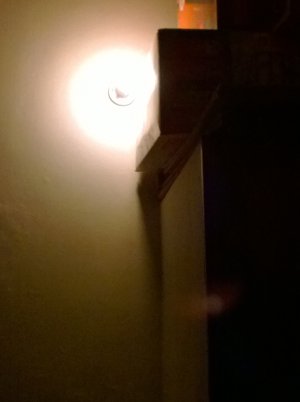

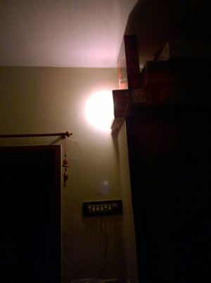

I am getting some sort of reflection in my low light snaps with Lumia 1020.
Hello all,
Whenever I try to take a picture in low light example of a candle or a bulb I see a dot in my field of view which moves as i move my phone. It becomes worse when I try to capture multiple lights say for example an array of LEDs. It is very irritating to find something like this on snaps taken by such a good camera phone. Please help me out in this and what can be done about it? As you can see in images attached just above the switch board on wall in 1st and 3rd image and on edge of cupboard in a close up shot in 2nd image.

At OP:
This is the Lensflare which occurs due to light refracting through the six lenses inside your camera assembly.
It's nothing to worry about. You can circumvent that when taking a shot from a different angle. ;-)
If your lensflare or light is smudgy, you need to clean the outer lens with a soft cloth but other than that: It's working as expected :)

thanks a lot it relieved me a lot. Tomorrow I was planning to go to service center and actually didn't wanted to operate my baby.
