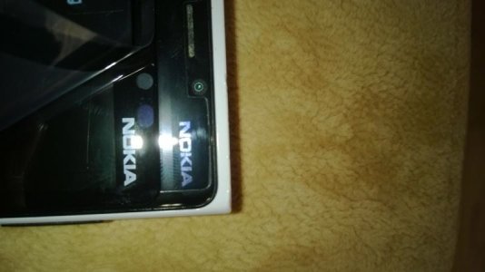

Upon closer inspection of the pic myself, I can actually make out the Nokia logo on that specific digitizer when I angle my screen in certain ways, which hints at marker covering it. So I'm also hoping he just doesn't know the parts well enough to speak about them. But yeah, I think that's crazy. Based on how many digitizer resellers there are, it seems like you'd have to go out of your way to NOT put the logo on.
i had also observed it and i was 100% sure that it was a marker. There would not be nokia logo at all. I cannot find any reason to print it in black.

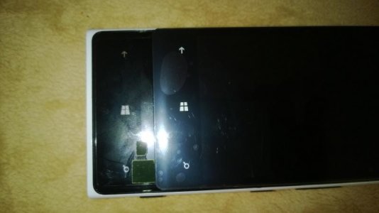

ok i received it. THe part is fake. Nokia logo exists but it is bold. But the worst thing is that the capacitive buttons do not have the mirrored color. The are printed grey and are smaller than the genuine one. I will post pictures

f88 do you parts include mirrored buttons or printed?

Mine don't look printed on, they have the mirrored quality to them. I'm sorry to hear it's a fake...Are you still going to go ahead and install that one or keep shopping around for an original part?
i will ask a full refund and try to find a genuine one. the problem is i cannot understand it from pictures.! Even the seller with 100% feedback i had found, told me that they are not mirrored. It look strange to me. They buy it and do not care if it is mirrored or not?

BUT the capacitive button are printed silver and do not have the mirror effect! Moreover, the left arrow seems fake compared to the original one
