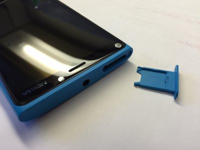

Oh noes! I had to use my iPhone 6 the other day, so I tried to pop out the SIM from my 920 but the SIM tray was stuck. I pushed it back in, and tried ejecting again but it wouldn't pop out fully. Wiggling it around didn't help, so I pulled at it gradually harder and harder until it popped out. I thought all was fine until I tried to put the SIM back into my 920, but it doesn't detect the SIM. In fact, that little secondary tray that pops out with the SIM tray doesn't come out. I don't know how to fix it. I looked around the forums and I hope I don't have to pull it apart to replace it with this thing: Nokia Lumia 920 SIM Card Slot Socket Reader Holder Replacement | $0.73
Has anyone else experienced this issue?
What I found was the simm in the 920 is not exactly cut to fit properly even thought it looks it. I would go to a corporate AT&T store and ask them for another simm card. Its free.
I should mention that I am using an adapter from the Nano Sim to the Micro Sim. I have tried to look inside to figure out how to pull out that secondary tray, but not yet desperate enough to take the phone apart.
What secondary tray are you talking about? Have you tried restarting? My 920 needs a restart to recognize my sim after a pull
Did it get stuck while trying to pop the sim? (something i had happen attempting to use those Nano Sim converters.) Sounds like its being trapped by that spring-load mechanism that makes contact with the sim card and now won't come out.

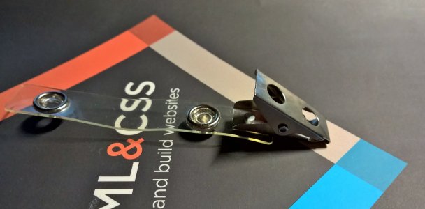

Been there, well almost. I was on track to break some things before I investigated what that snap/catch sound was when you put the sim in a phone. When I found out what it was, I had an idea how to try to remove the sim from the slot. I needed something flexible, but it had to be strong enough to push the spring back. So digging around in my desk, I found this ID badge clip I wasn't using.
I cut just above the lower snap on the end and had my tool. It was slim enough, strong enough and made from plastic so I reduced the chance of damage. I slipped this into the sim slot getting it between the snapping mechanism and the adapter and I was able to extract the adapter and sim. I won't go back to using those adapters unless they specifically say they are designed for the Lumia because they are too hit and miss.
