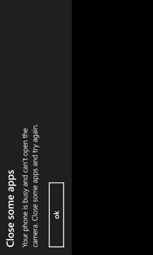

Did you get the following msg while using Nokia Camera?

I got this error. Once. But I suppose the app will be optimized as ProCam, now Nokia Cam was never meant for 512 MB Devices
I restart my phone many time but the problem still there. Reinstalled too. Running on GDR3 Lumia 720. Just sometime it shown up.
I get this error also, but only when I click the view/reframe button. Must be a memory thing? Installed on Lumia 720
