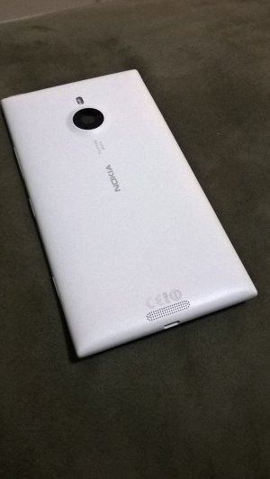

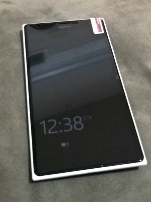

I got hold of an unused white 1520 :-) . It was claimed to be unlocked, but it was the AT&T version. Anyway, the phone looks brand new with the screen tape till on and Windows 8 on it. The manual with the phone says RM-937 though...

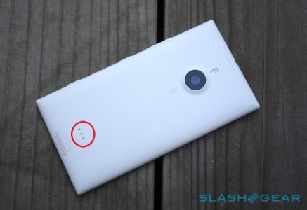

It's not the AT&T version. Unless the case was swapped (unlikely). It doesn't have the 3 pogo pins on the back that all AT&T 1520's have.
Your Purchase:
Stock Photo of AT&T 1520:
See the difference?

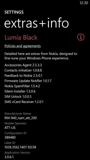

Thanks for the info. When I restart the device, the AT&T logo comes. Also, this is what I see in Extras+Info:
At the end there is a MADE IN CHINA and the below text
Model : 1520.2
Type: RM-940
FCC ID:PYAB

Hmmm... They may have flashed an ATT ROM onto an RM-937. Where's the pogo pins for the PMA charging jacket?

which indicates, indeed it's an AT&T version.
