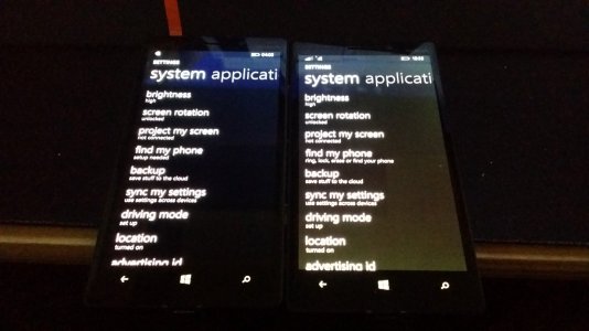

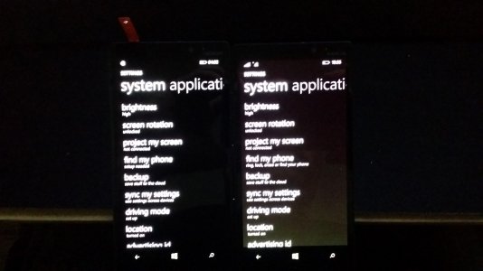

Have a look at these pics..
One is my 930 - black arrived today and the other is my partners 930 - black that she bought today!
Here is a side by side pic with both phones on high brightness...
one perfect black, the other not so much...
Mine is definitely black in lowlight, that looks like some crappy IPS screen and I would definitely try a full reset then if it's not resolved - return it.
Definitely return the right one. It's a hardware defect.
View attachment 73100View attachment 73101
I'm very confused now... The issue for me is not visible when displaying the pure black OS screens with white text. It's only noticeable when a black or very dark image file is displayed.
