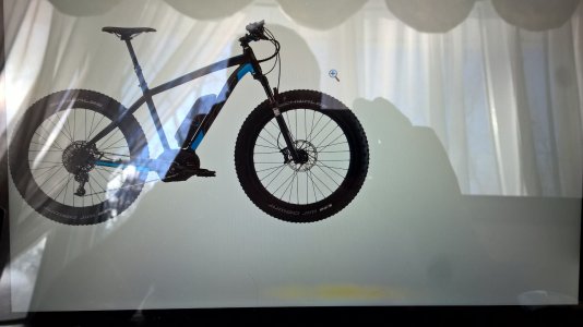

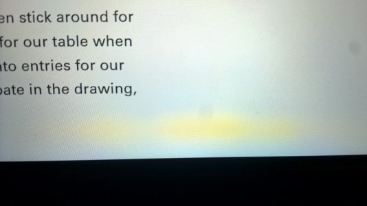

About a day after my Surface Book took the 2-17-16 firmware update, I was working late and noticed that I started to pick up a yellowish discoloration at the bottom center of my screen. I wasn't sure at first, but I did a snip, saw nothing and realized that it wasn't the graphics but the screen itself. I tried restarting but that didn't resolve it, so I took a picture of my screen with my phone. It looked like this:
The next day I came back to my book and it worked as normal again. It's only been in the last few days that the problem has returned.
I have noticed that my fan has run excessively since the update, and the book tends to be very hot all day. It seems that after several hours of use, the heat is causing a discoloration that subsides again after a period of disuse. It's most noticeable on the bottom center of my screen but also happens along the right edge of the screen running vertically about midway down.
Has anyone else been experiencing this? Do you think there will be another firmware update to correct this or will I have to exchange my book again?
This is surely a hardware defect and it's under warranty cover.
So I think your best option is asking for exchange.

This is a hardware overheating issue. It's been posted about on Microsoft's own forums repeatedly. The best thing to do is to contact MS support before you have something like the screen crack from the excess heat (it has happened to people who have then been told that they will not receive warranty support because of the cracked screen). Get your device exchanged -- the best place to do it is at an MS store, but if you don't have one close by, do the exchange via their online support.
Zerospace is 100% correct. It happened to me after a "hot bag" issue where my SB got very hot, just kept getting worse from there. I brought it to a MS store and they replaced it on the spot, and I have to tell you it was the best thing I ever could have done. I had constant issues with my SB and the exchange fix all of them, including the discoloration on the screen.
