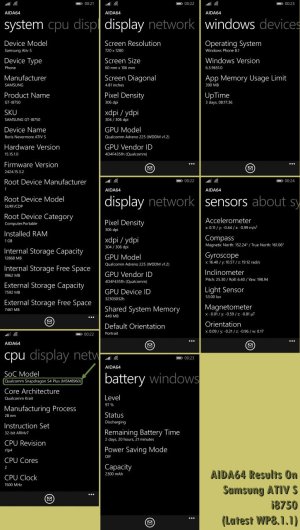

I found something interesting, AIDA64 states that the ATIV S has a SD S4 Plus MSM8960 in it so we have BT4.0 and LTE Support.

I am surprised you didn't know that so far? Yes we do have that but i guess we need to be interop unlocked (guess that's the level we need to tinker with the Registry?) and i am sure that the bands for LTE are there but we somehow need to find the registry that enables that. Someone with more WP hacking knowledge please correct me if i am wrong. So far I think grozaman can try this on his ATIV S since mine is still not interop unlocked.
But for the sake of confirmation, I will check if AIDA64 will say the same for my ATIV S too like it said on neo's ATIV S.
No, T899M and I8750 have different chipset (some guys already checked this). So there are no registry hacks to enable LTE on I8750 model. BT4.0 theoretically there, but it's hardware disabled by Samsung. Samsung can probably activate it, but apparently he's too lazy :D

Ok, I just did a test with AIDA64 and here are the results:
(I scale down the images but the image of all test screen together got big again)
However, it is too bad that we have the CPU but we cannot enable the LTE, what a shame...
Anyway, grozaman, what kind of unlocking level we need to get the registry we usually cannot? Developer unlock or Full Unlock?
Ok, here are the screenshots from AIDA64 from my phone put in one picture:

If I understand grozaman, we have on our i8750 ATIV S's a different chipset where LTE doesn't exist.
Oh I knew that so it was more for the benefit of those who didn't know. LTE would be difficult to get working for several reasons, it might be disabled in the firmware or on the SoC itself not only that I would guess the antenna we would need is missing as well. Also the MSM8960 has support for LTE but chances are that it's disabled in the SoC rather than firmware.
Just a note: Even with the Interop Unlock, you cannot edit the entire registry. Often, the main system partitions of registry can be edited only by using customs. So it's cause the problem to test quickly.
Go check the specs for the SD S4 Plus MSM8960, the SoC in the i8750, and you'll see that it DOES have BT4.0 which was enabled with WP8.1 as you can pair BT4.0 devices to it. LTE would be in the SoC itself but disabled as the relevant antenna isn't in the i8750.
