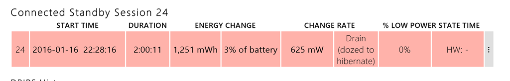

New Intel drivers appear to solve Surface Pro 4 sleep power consumption issue
Users of the Surface Pro 4 may get some relief today as Intel's latest driver update (15.40.14.32.4352) appears to address the notorious issue of high power consumption during 'sleep' mode.
While Intel's last driver was released at the end of December, it has not been made available to Surface Pro 4 users, nor will its normal installer allow owners of the device to apply it as it has not been validated by Microsoft. However, users can download the ZIP file, extract it and then install it normally from Device Manager.
Where the November driver would consume over 2000mW during the test, the new driver uses a relatively meager 625mW during the same time:
Previous drivers showed multiple Intel devices being active 100% of the time during sleep. The new drivers appear to address this.

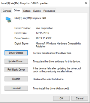

my driver details are:
Intel Corp
12/15/2015
ver 20.19.15.4352
Intel Iris Graphics 540
I do not see any events yet in the logs for this driver but I will watch and let you know if I see anything.
fyi
I did the manual install which is the only way to install these drivers at this time.

I don't think you're on the latest still. The latest drivers for Gen 6 intels ( including yours ) should be from 12/22/15 based on the intel website. Have you had a look to confirm that ?
DRIVER VERSION: 15.40.14.64.4352 & 15.40.14.32.4352
DATE: December 22, 2015
Intel Corp
12/15/2015
ver 20.19.15.4352
fyi
Not sure why my post ddnidn't quote you. But it was for you the latest drivers are : DRIVER VERSION: 15.40.14.64.4352 & 15.40.14.32.4352
you're on the 15th, have you confirmed that you'res is actually the latest ?
