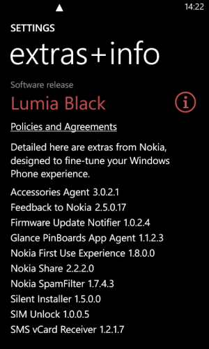

Lumia 620 Black update
i tried to work offline, and now i'm done, the update is correctelly installed, , everything is ok , thank you
Nokia black update reached to India :)

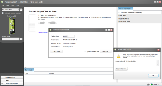

i am getting this error the update could'nt be downloaded. (801882d2)
what to do ?? whenver its getting upto 14% its giving this error :(
one thing i am not understand if you goes offline then how you download update pakage..
i used Nokia DataPackage Manager (this package can be downloaded separately , and included in NCS) to dowload the finish update , and loged in offline, then updated my phone
is there black rom for indian variant on nokia data pakage manager...plz reply
As far as I've heard, Nokia India has put certain restrictions on ROM availability for Lumia 520/620/720 through Nokia Care Suite and Nokia Software Recovery Tool.
You may as well try to update to Lumia Black OTA using WiFi and thereafter Factory Reset your device to achieve a totally 'fresh' state which is exactly what you get if you flash a ROM on your device.
Como pongo el celu en flash mode, Me funciona bien el celu, solo quiero instalarle la black update, hasta la descarga del firmware va bien, cuando tengo que conectarlo en modo flash, se reinicia el telefono normalmente.
