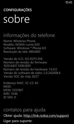

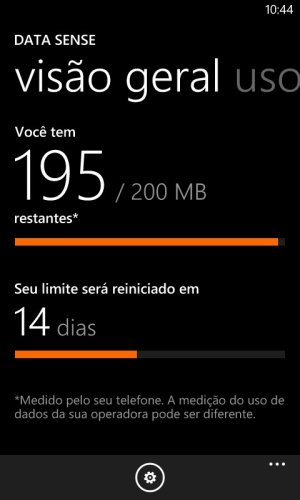

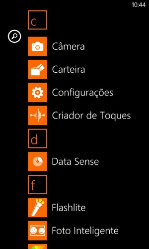

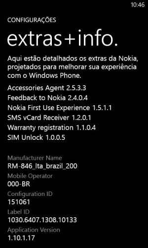

Not possible I guess, since I?ve used the Nokia Suite to search for the firmware and the suite looks for the product code to download. Even the size was the same as before. After my work I?ll post a print of my screen of the about section and the data sense, what I suposse it?s giving me this trouble. I even tried to use VIVO firmware wich is my carrier but the phone do not accept other firmware than the specific one. I?m going to dump this phone as soon as the 928 is ready for sale here. Thanks.
updated: print of my screen, sorry it is in portuguese. I?ve tried to set a limit in datasense, I don?t know frustration is the worst feeling.
