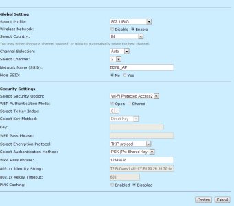

Hey every one... i am a newbie to the windows platform i bought a lumia 720 couple of days back. I tried to connect my phone to my wifi modem but gets an error ("CONNECTION UNSUCCESSFUL " unable to connect to net work). I use the same modem to connect my laptop and PS3 wirelessly.
I tried with secure and open connections from modem but was of no use ........
Then tried making a wifi hotspot using connectify and it worked fine !
guys any help will be appreciated . here is the screen shot of my modem's wifi setting
Try switch your security options on the modem? Also try by deleting the SSID from your Wifi settings on the phone, then reboot your phone, and let it find it again and reconnect.

When i contacted nokia they said ip based connections are not possible. By the by i managed to resolve the issue by resetting my modem and entering the credentials again.
