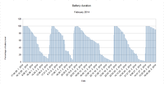

I've encountered a bit different problem now. I have Lumia for 6 months now and for that time battery duration was between 3-6 days while phone was not in "active" use - I mean using phone only to read messages, short calls and quick reading of weather forecast. (Of course when I played games or used any other battery consuming apps, batetry duration was much more shorter).

Well, I'm not making jokes. I have lost history of my battery in my phone during re-installing some apps including battery monitoring app, but longest battery duration was 8 days, average 5 days.
I have backup of measured values from that app as plain txt file at One Drive. After picking e.g. values from February, putting it into OpenOffice and making a graph, it looks like this:
As you can see, I charged battery 5 times per month, it makes average of bit less than 6 days duration.
So this is why I am nervous, dropping from 5 days of duration to 1 day of duration.

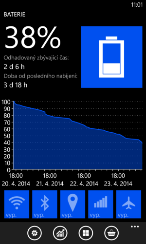

To close my case - problem was apparently caused by one of those app updates. After phone hard reset battery usage returned back to "my normal". I used phone to calls, reading messages, reading e-mails, web browsing, short music listening and last three days battery usage looks like this:
For those, who cannot read Czech:
Odhadovan? zb?vaj?c? čas = Estimated remaining time
Doba od posledn?ho nab?jen? = Elapsed time from last battery charging
So to sumarize - only solution, that worked for me was hard phone reset.
