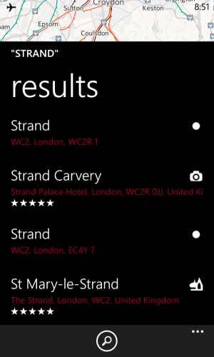

Strand -- several random towns including some in Ireland!

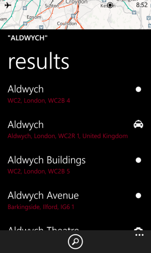

Aldwych -- Nothing

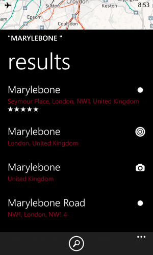

Marylebone -- finds it, but strangely navigates to a neighboring minor street

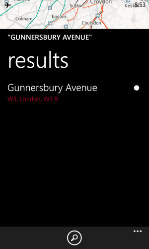

Gunnersbury Avenue -- Nothing

Just tried an OFFLINE (airplane mode) search on Gunnersbury avenue and got nothing, but if i enter Gunnersbury avenue, london i get all the correct results. (I conducted this search from my location in Somerset)

OK, now I'm seeing what you see. Type in the city name along with the street and you get good results offline. I just tried some obscure little streets and it found them quickly.
Thanks, Huime. You were right.
But that does rather beg the questions
- why the random results if you omit city/town?
- why does it work without city/town in online mode but not offline?
I hope Nokia intend to do a good job of educating new users to their approach, otherwise there are going to be some very irked ex TomTom users.
