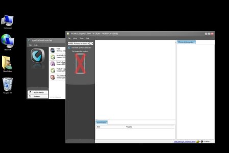

I tried to debrand my lumia 920 using nokia care suite but for some reason when I connected my phone it said that phone is not supported but in the readme it says it is? any ideas

Sorry I'm not sure why that is, I've flashed my 920 several times with different roms. Is yours a US handset?

get you now so you managed to flash your 925 with an unbranded rom successfully, and flashing does not effect sim locking, the only reason I mentioned 920 , is because I already own 1 of them and I tried to flash a rom to it but in nokia care suite it said the phone was not supported as shown in the screen shot I attached to a previous message, ?

As for your 920 is looks like the version of NCS you are using might be too old? Look at the last post here http://forums.windowscentral.com/nokia-lumia-920/214115-not-supported-product-identified-rm-821-a.html don't install the latest version because you won't be able to sign in. I'm using version Nokia_Care_Suite_PST_5.0_2013.10.1.3.

Hi I have the latest version the funny thing is that it says its supported in the readme,could it be something todo with Windows 8 what operation system you using?
