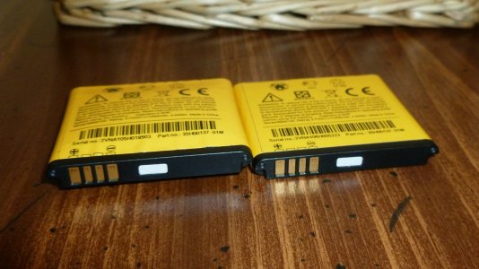

A 'bad' phone bulge would look like
If it looks like this it is damaged. You should immediately stop using it, handle it very carefully, and if in warranty get a replacement (well, if not in warranty too - just you'll have to pay).
