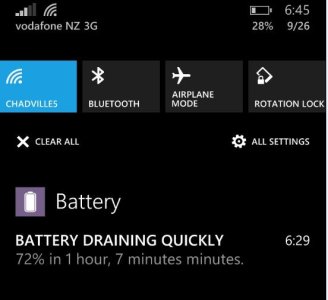

I had the same thing happen to me after the Cyan update. Phone had been charged overnight so was on 100% battery. Installed Cyan, then left my phone sitting there doing nothing. Came back 1 hour later and saw my battery was down to 28%. Can't remember how hot it was, but did a reboot and it hasn't happened since. Been going fine for about a week.
