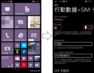

Turning off the cellular data does not hinder your ability to send or receive text messages, though Cortana and speech-to-text will not work without cellular data enabled. GPS will still provide you with your location and you can still follow directions to a destination, but you generally cannot enter new destinations that are not already stored in your phone. If I need to go to a new place I usually enable cellular data, locate the place I want to go, get directions, and then turn off the cellular data. My phone currently runs Windows Phone 8.1 Update 2 which permits the pinning of individual settings to the home screen. I went to the settings menu, tapped and held "Cellular + SIM" and pinned it to the start. If I absolutely need cellular data it's only two taps away if you're already at the home screen, three taps if you're not. See the screenshots I attached to this post. My phone's default language is Chinese, so apologies there, but the settings are in the same order and the functions are the same regardless of language.
