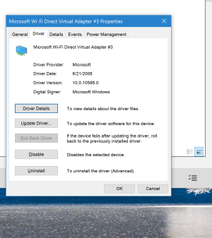

How far away from the dongle is your sp4?
Also , what is the firmware version on your sp4?

I just got the 11/26/2015 firmware update automatically via the Wireless app 1.3.8305
Huh? I'm confused. Is the driver version the same?? the 2006 driver?
That driver and the firmware for the adapter are two different things.
10.0.10586.0 and 6/21/2006 on Miracast V2
